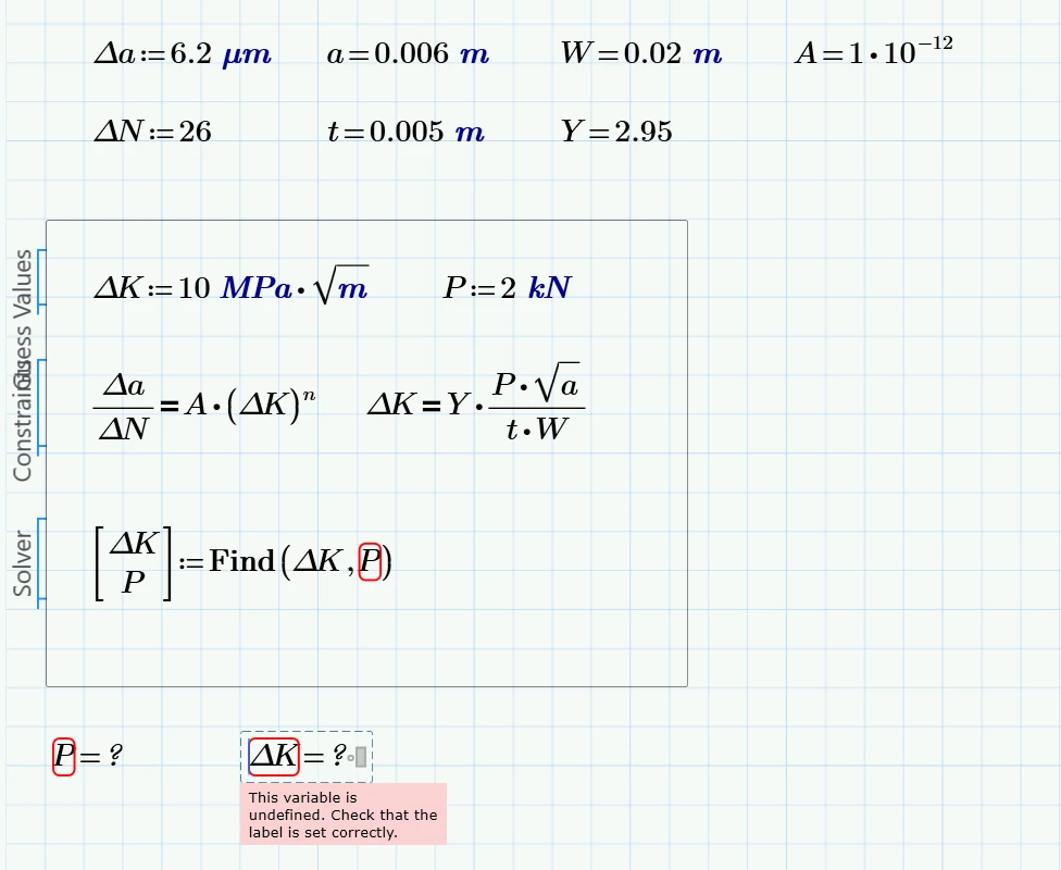

You haven't defined superscript n.
Alan
PS It's usually best to upload your worksheet, not just an image.
The units in your first equation don't balance, neither if we assume n=2, nor for any other value of n.
The left hand side is of dimension "length", the right hand side pressure^n * length^(n/2)
23-Emerald I
Fatigue crack growth using Paris' parameter can be a bit of a challenge.  See if the attached can give you a place to start from.
