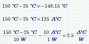

Hey All
Im having to endure the uphill battle of using a new program especially on windows making it even harder given I'm a mac user
Please see the picture below
What went wrong here?
The answer very clearly should be 2.5 C/w
And this thing is freaking out giving me whatever the heck that is.
Im sure I'm just missing something simple
Thanks in advance.
February 1, 2016
Well, it's not very helpful but it's correct - it's displayed the units using the most basic elements (mass, length, time, temperature).
°C = K, provided you're talking about relative values (true for a gradient such as this).
W = J / s
J = N.m (therefore W = N.m/s)
N = kg.m/s^2 (therefore W = kg.m/s^2 . m/s = kg.m^2 / s^3)
Therefore you have K / [kg.m^2 / s^3] which rearranges to K.s^3 / kg.m^2.
As a MathCAD newbie, I have no idea how to make it display the units in a more helpful form, however!

February 1, 2016
You have learned from the previous answers that Mathcad per default will display results in standard basic units of the chosen unit system and that you can change the units of your results by simply overwriting the displayed units with the units you would like to see. But now for the real tricky part - temperature units:
You thought that 150 °C - 25 °C would yield 125 °C, right?
Give it a try and be surprised by the result -148.15 °C !
Temperatures are somewhat trick unless you solely work in Kelvin. Don't blame Mathcad for that - the reason is, that the conversion from standard unit Kelvin to Celsius is not a simple multiplication as with most other unit conversion but that we have a scale shift here.
Mathcad makes its calculations concerning temperature in Kelvin. 10°C=283.15 K and 0°C = 273.15 K. So 10^C - 0°C = 283.15 K - 273.15 K=10 K = -263.15 °C - ouch! We have to distinguish between temperature and difference of temperatures!
You may have noticed that Prime offers a "unit" Delta_ degree_Celsius, too, and this could be the solution to your problem.
