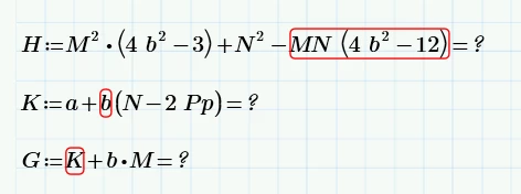

When I was writing an equation, I got the message "Units are not compatible"
Can someone help?

In the equation for:
  • H you've typed "MN" instead of "M*N"; the variable MN doesn't exist.
  • K you've typed "b(" instead of "b*"; the function b doesn't exist
The equation for G is OK after changing K.
In such situations, try copying each additive subexpression and evaluating.   That often shows the root cause of the problem.
Yes, but MN is interpreted by Prime as unit MegaNewton and thats the reason for the unit mismatch error message 😉
