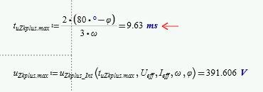

I have a very bizarre error that I just can't solve.
See the following:

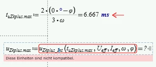

This gives me the "units are not compatible error" if I use t_uZkplus.max.

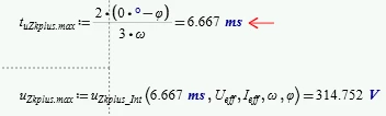

If I put the solution for t_uZkplus.max manually in the lower line it works just fine:
I really don't understand what is going on here. Does anybody have an idea?

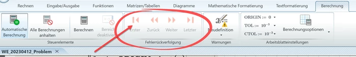

You may use the error tracing - maybe knowing the line in the function u.Zkplus_Int( ) which throws the error can help in finding out what happens.

What is even more weird is the fact that it depends on the value of t_uzkplus.max.
As in the opening post it doesn't work if the result is 6.667 ms (well it works with 6.667 ms if I manually copy the result into the function):
But it does with a different value:
