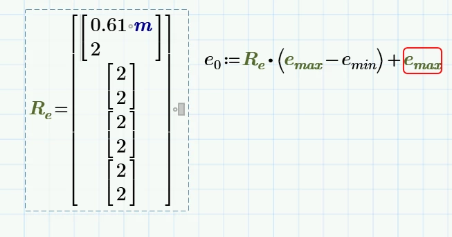

What are the units of Re?
Jul 6, 2026 11:26 AM UTC
unitless
23-Emerald I
Jul 6, 2026 11:42 AM UTC
You are probably be right!  the result would be another nested matrix if it worked.  (Just tried in Prime 4.0 and it worked)
The other option would be something mis-labelled.  Then there’s this:
Jul 6, 2026 11:43 AM UTC
That’s great , but if you notice Re has different rows .. not all of them [2X1]

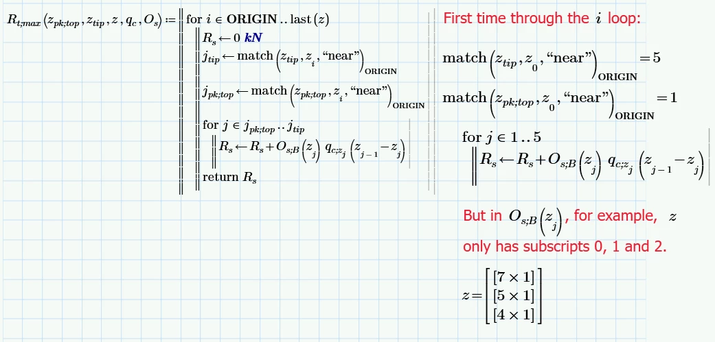

Jul 6, 2026 11:47 AM UTC
From your worksheet:
Might be better to pass each [nx1] component of z to the loop individually.
Sorry, this should have been posted in your previous post!
Alan
Jul 6, 2026 11:50 AM UTC
Os;b(z) can be taken as Os a fixed number not function,,
Jul 6, 2026 11:57 AM UTC
It’s the subscript on the z that is the important point!
