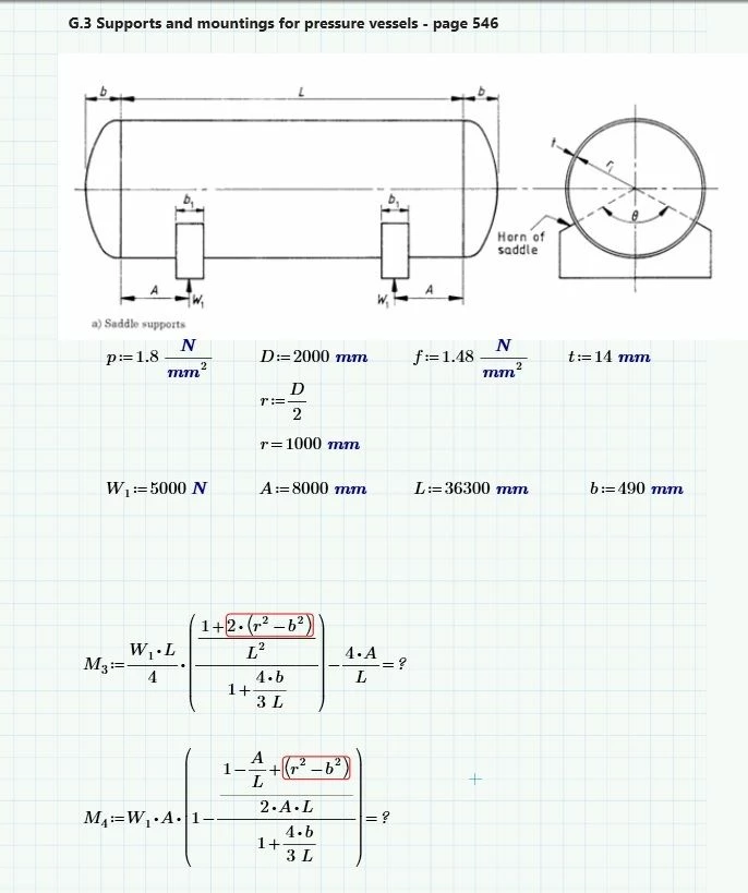

Units are not compatible
can someone please help.
i have tried everything but i can not get it to calculate.
Keeps saying Units are not compatible
    Mike_EganAnswer
    November 20, 2018
    done, all sorted, thank you all, it helps if I copy things down correctly, brackets and division in the correct place.

    November 19, 2018
    In M3 it looks like you are trying to add 1 (dimensionless) to r^2-b^2 (dimensions of length^2).
    Similarly, in M4 you are trying to add dimensionless quantities to dimensional ones.
    Alan
    November 19, 2018
    What is the origin of the formulas?
    May be it is an empirical formulas?
    Mike_Egan1-VisitorAuthor
    November 20, 2018
    hi the formulas come from a pressure vessel design code, PD5500
    November 20, 2018
    Compare your expressions with those in the design code very carefully.  You will see that you have got some of your division lines in the wrong place!
