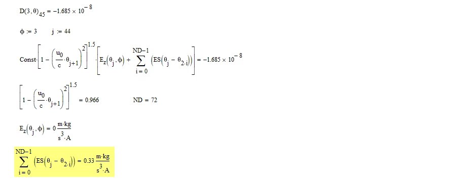

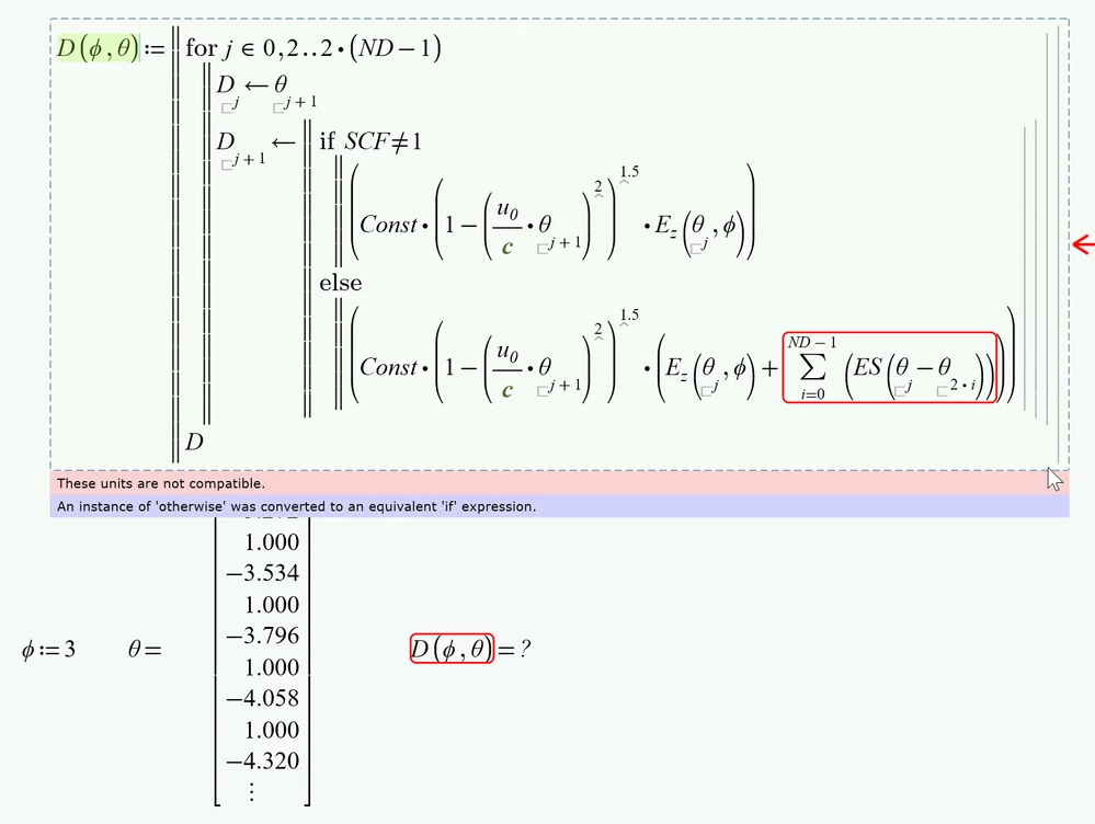

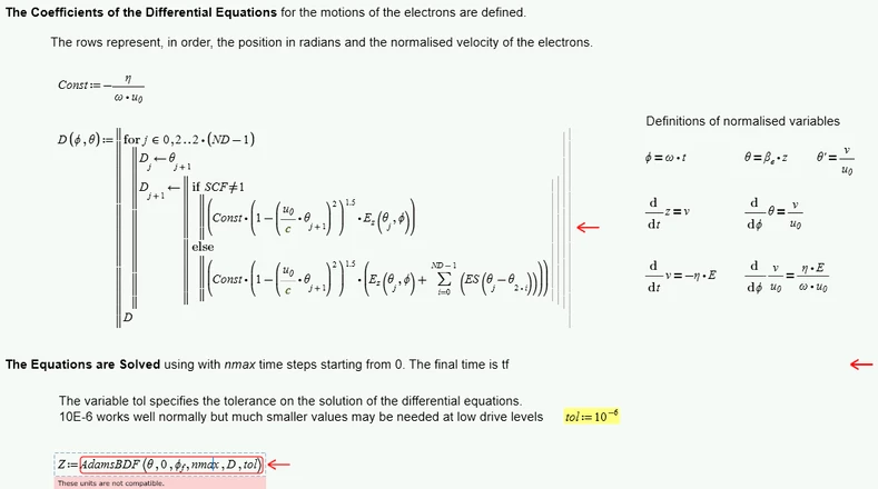

I have a worksheet created with Mathcad 15 and was recently converted to Prime 8.0. After the conversion, I got this error message saying "units are not compatible" in an ODE solver as shown below:
The initial and final conditions were defined as
This problem did not occur in Mathcad 15 and before, and I have been struggling for days to solve this.
Does anyone have any suggestion?

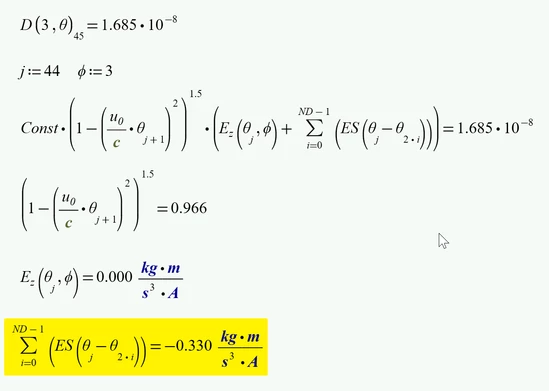

Hmm, I looked at the index 45 and calculated it outside the function in MC15 and Prime.
The main difference occurred in the sum calculation

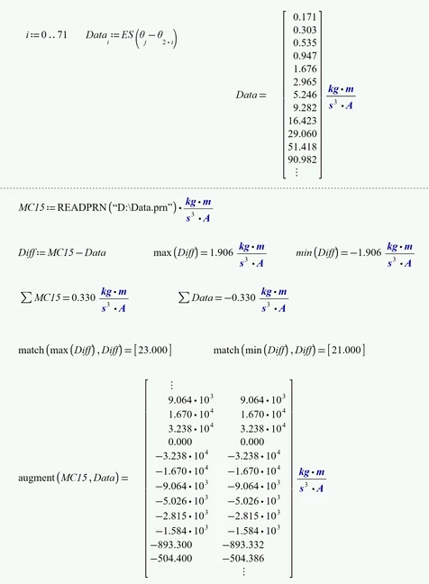

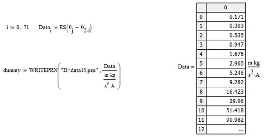

So I looked at the individual summands but could not spot a significant difference with the naked eye. Therefore I exported the MC15 result and imported them in Prime.
As you can see, the two vectors actually sum up to about the same value bt with different sign. But largest difference of the two vectors is just +/- 1.9 at values in the range of 10^4. Thats not much of a difference, but on the other hand the sum of the vector also is just +/- 0.3. This means that the large positive and the large negative values in this vector cancel and small differences may push the result on the positive or negative side.
I would also guess that these differences are not the cause for AdamsBDF failing (but then - who knows?).
I have to leave it up to you to further investigate in the (only small) differences in the two vectors, find out where they may stem from and if they could be responsible for the ODE-solvers failing ...

Check please what values returns the D function!
One example.

I guess the sheet doesn't use any units, right?
Its hard to debug just a picture so if possible you should attach the sheets (Prime and real Mathcad).
We don't see where and how "c" is defined in your sheet.
My best guess is that the "c" in your definition of the function D is labelled as "constant" and so is interpreted as speed of light.
Try to relabel "c" in the definition of D(...) as "Variable" and see if it helps.

The sheet does use units, but both "phi" and "theta" are unitless for D.
Changing "c" to a variable doesn't seem to solve the issue.
I am attaching the worksheet (Prime and Mathcad 15) here. As you can see, "Z" was computed correctly in Mathcad15.
I would really appreciate it if you can help me look into it.

OK, I see that c actually is supposed to be the predefined constant for speed of light and its units cancel with those of u.0.
So of course c should not be labeled as Variable.
Also the units of E.z and ES cancel with those of "Const", so D is actually unitless.
I also can confirm that the MC15 sheet is working OK.
At the moment I can't see whats the cause for the sheet failing in Prime and which units it thinks are not compatible .
Numerical algorithms have been changed when going from MC to Prime, so my vague guess is that this could be the cause of the problem.
One additional observation:
When I try to evaluate the function D( ) with an arbitrary (unitless) value for the first and the predefined vector for the second argument, I get the very same unit mismatch error, but this time we can trace it back to the sum in the definition of D ().
Nonetheless I could not find anything wrong here ...
