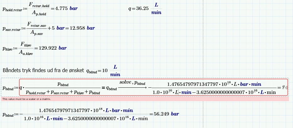

I have a problem calculating with units in Mathcad Prime 4.0
When using the solver with units, it often gives the error "This value must be a scalar or a matrix" but it seems to solve just fine, with small modifications.
As you can see, it solves the problem, but when i put an equal sign afterwards it gives the error.
When i copy the result and pase it (underneath the error) and put an equal sign, the same thing happens, but if i
delete the last "min" in the down right corner, and replace it by writing "min" it gives the solution, which here is 56.249 bar.
Why doesn't it solve in the first place? I delete a min and replace it with a min, and that solves it??

The symbolic processor of Mathcad (and Prime) does not know units, It treats your 'm', 'bar' and other units as (unknown) variables.
If you want to work with symbolics, start with solving the problem with only symbols.
Then fill your (united) variables into the solution.
See here for an example: https://community.ptc.com/t5/PTC-Mathcad-Questions/Reduce-solving-solution-Intermediate-calculations/td-p/491698
