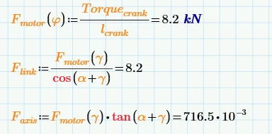

I am using Mathcad Prime Release 8.0 and Datecode8.0.0.0
I have set of formulas with a units. If I change the unit on the result of the first formula the following formulas are loosing their unit.
Here are the errors that I faced
No error message or warning. Inconsistent results.

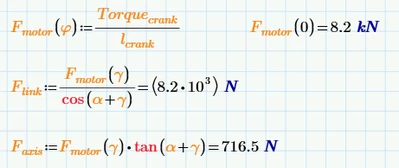

1. You have defined F.motor as a function of phi, but it does not depend on phi. Why did you define it so?
2. You have defined F.motor and use an immediate evaluation ( the =   )  at the end of the definition. While that works to display the value, it (too) often leads to problems due to 'side effects', as in this case.
If you delete the = from the end of the definition of F.motor, the problem is gone.
If you want to see the value of F.motor, type an extra F.motor=, to get:

Hi Luc,
Here is the MCDX file. When I change the unit from N to kN the units in the subsequent lines get lost. The value is changing as well. I would have expected I can change the unit of the result after the (= sign) independently to any other unit of force.
