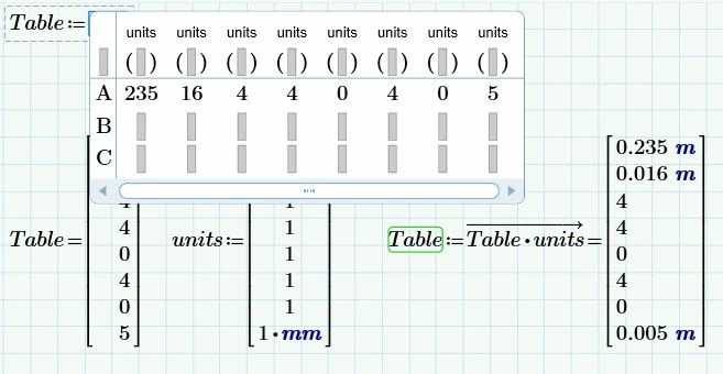

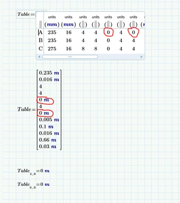

Has anyone encountered this before?
In my Combobox, dimensionless inputs get units. You see the problem below. I'm thankful for any advise how to get rid of the problem 🙂
terryhendicott
Apr 21, 2023 6:42 AM UTC
What you have found is a bug in Prime.  It is reproducable.

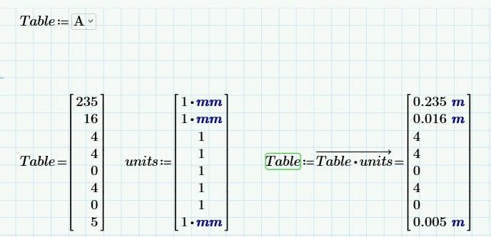

Workaround is like this:  Don't define units in the combo box but in a vector that can be applied.
Cheers
Terry

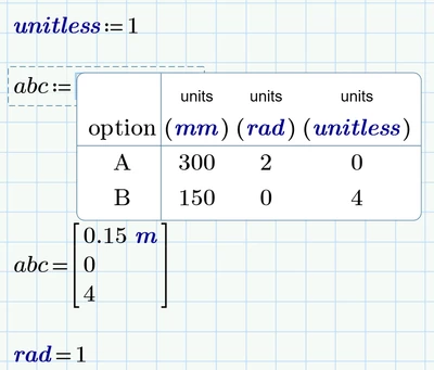

A more convenient workaround for this bug is IMHO to just use a pseudo unit like "rad" (which actually equals to 1) in the unit placeholder for the unit-less quantities.
If you don't like to see "rad" written when you edit the combo box (you would only see it there), you may also define a custom unit "unitless:=1" in front and use this instead of "rad".

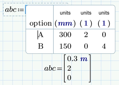

OK, don't let us make it more complicated than it actually is 😉
No need to use "rad" or a custom unit. A simple "1" in the unit place holder (it gets labelled as unit automatically) is all that's needed to force even zero values to be unit less
