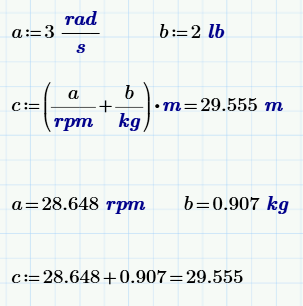

I know it is possible to control the unit of the result in an equation. Is this possible as well within the equation itself or do I have to put in a correction value instead?
E.g. I am doing some calculations where the defined variable in the equation must be entered as rpm where as the variable is calculated as rad/s, which is the SI unit.
Thanks in advance,
Ronnie.
January 27, 2017
You mean something like this?
One metre plus one foot plus two inches, result expressed in metres. But could just as well be in inches:
In general you should avoid to enter any 'correction constants' (especially as constants) in you formulae. Just add the units.
The big advantage of Mathcad (and Prime) is that it can calculate with the units.

A lot of old engineering books give you equations with unit conversion factors "built in," and require values in specific units.  If the expression is correctly unit balanced ( torque times shaft speed equals power) then Mathcad will accept any valid unit combination (Newton meters, ft lbf, etc.) and (rpm, rad/sec, deg/hour) and correctly report power (watts, hp, ft lbf/sec, etc) without conversion factors required.
If you expect on unit (hp) and Mathcad adds a few units that you didn't expect you have a problem--Mathcad is balancing units and your left hand expression is not "unit correct."
Unfortunately, some of the old equations were empirical, and what may look like a unit conversion factor is something else.  These require careful exploration.
