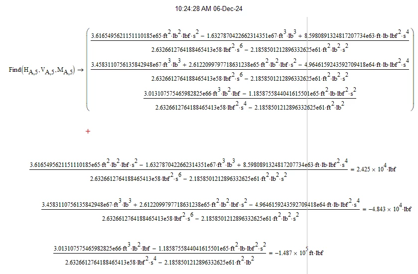

units in solve block not working
Hi, using Mathcad 15.0. I have a solve block producing some very strange units, and I can't get it solve with the right units.  If I take each result out of the Find, the units are right. Anyone know how to get this to work? Mathcad file attached.06-Dec-24 10-24-28.png

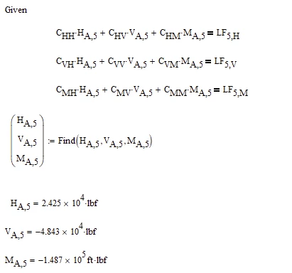

The symbolics does not know anything about units. So it does not know that lbf = lb*s^-2*ft and therefore it can't simplify its results.
I see no reason for using the symbolics as you are only after numeric results.
You already have provided guesses for the three variables, so stay with numeric solutions.
Because your three variables aren't of the same dimension (different units), Mathcad can't display them in one matrix, but you always can assign the result to a vector with separate variables and display them singly:
Mathcad would display the results using just the base units of the chosen unit system and lbf is a derived unit. So just type lbf in the unit placeholder after the displayed result and Mathcad will care for the rest.
