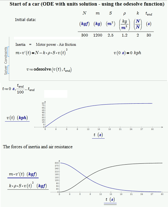

We can use units in Mathcad Prime by the solving ODE. It is very good! But I see one error:
8 replies
January 2, 2012
All is OK by the using the odesolve function:

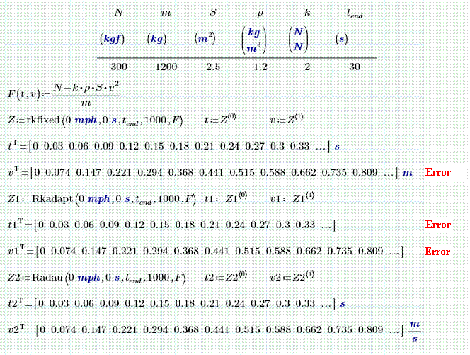

January 2, 2012
It is very strange:
rkfixed - 1 error
Rkadapt - 2 errors
Radau - no error
Viktor
January 2, 2012
(1+2+0) / 3 = 1 Error!
And then I was happy that the unit can now be used by the solving differential equations
One calms me - in Maple we have same disorder by using units in the solving differential equations
