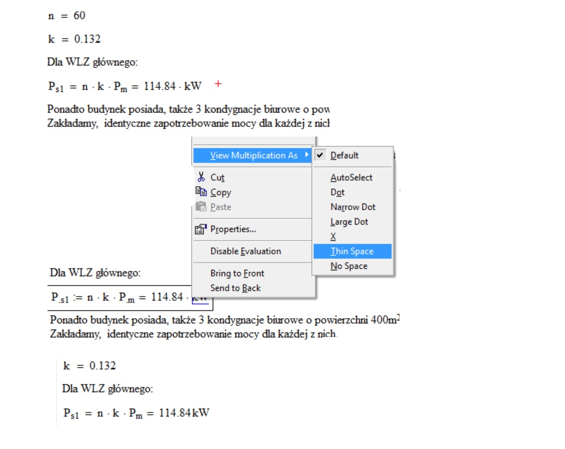

I have a problem with units in mathcad15. When i use function view multiplication as thin space for unit and then save and reopen that document unit back to the previous form.
After save and reopen units are in previous forms.

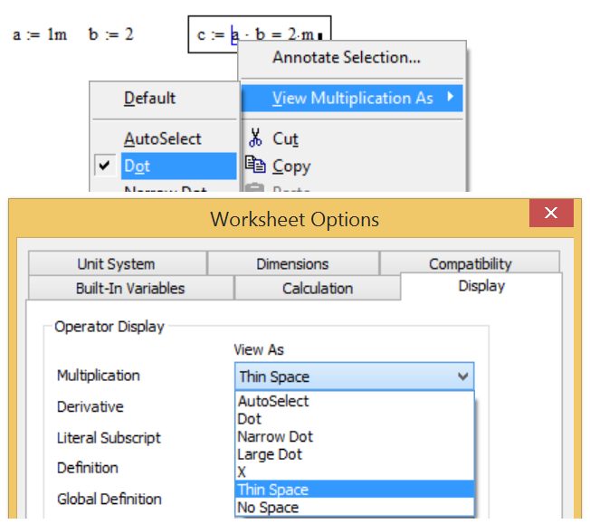

May be this help you. Open pls the attach

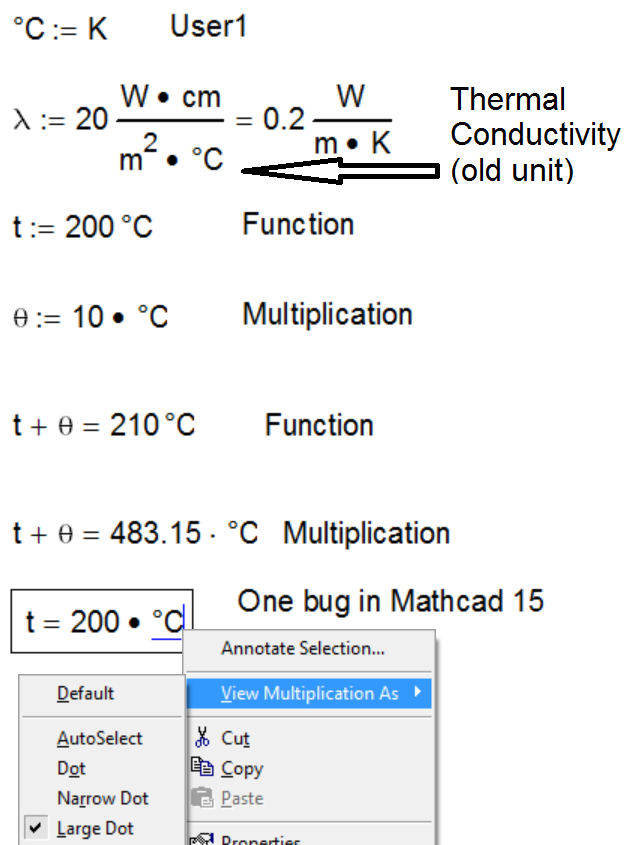

but I try to have dots between value and unit in my calculations.
Why?
See please
