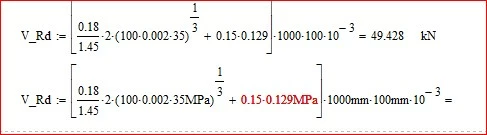

Hey guys. I have units problems when i use protencies and square roots. Can someone explain how i can solve this problem? for instance in the attached file i should have kN instead i get no units.

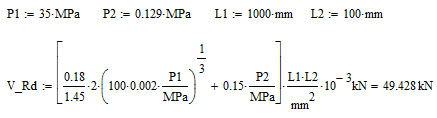

Here's an attempt:
and another:

What are the units of the cube root of pressure?
Mathcad is also complaining because your units aren't consistent, pressure and the cube root of pressure.
If you delete the first term in the parenthesis (get rid of the cube root,) then pressure times area will give you force

Yes, assign correct units to your constants.
Admittedly this could be sometimes difficult, especially with empiric formulas.
Don't know if this would make any sense but in your case You could write 100 MPa and 0.002 MPa to get the result you expect.
Or you could simply type 35 MPa^3 .
