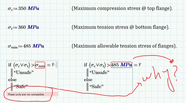

Werner_EAnswer
Mar 16, 2023 12:19 PM UTC
The comparison of sigma.c and sigma.t returns either 0 (false) or 1 (true) which of course can't be compared to 485 MPa.
You have to write it that way
BTW, you don't have to write the parentheses but I usually add them in such expressions for clarity
But you may also simply write
You may also consider using the if-function instead of the programmed if-statement
And here is yet another way to achieve the same result
DJNewman

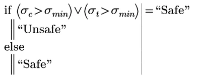

Because the (σc V σt) boolean comparison returns a 0 or 1 depending on if it's true or not, and that's a unitless thing that won't be compatible with MPa.
You'll want to do if (σc > σmin V σt > σmin) instead.

8-Gravel
Mar 16, 2023 1:17 PM UTC
Thanks.
