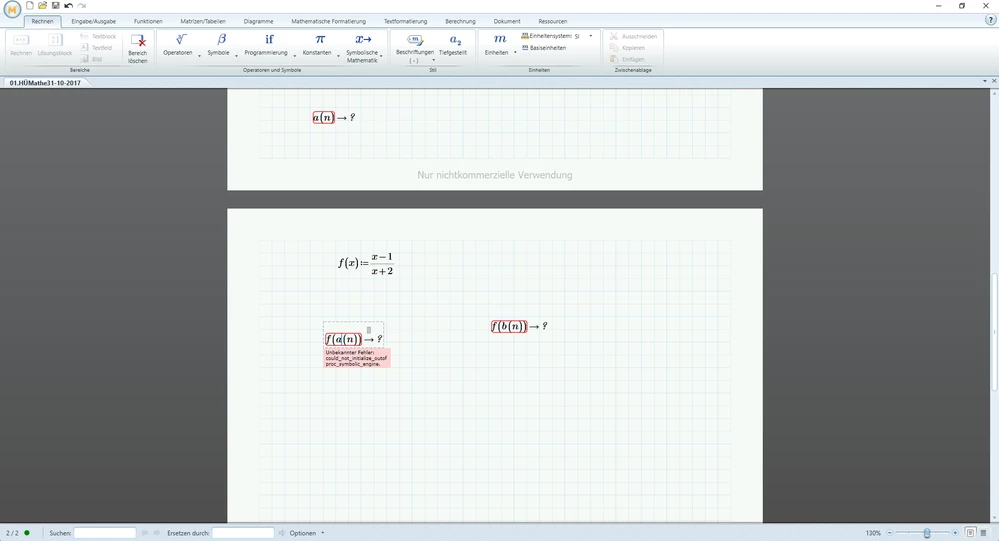

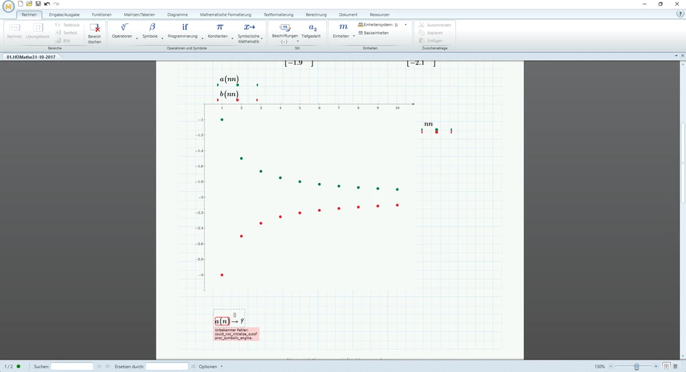

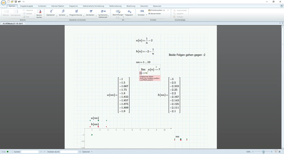

I was in school and writing things off the board when suddenly this error occured.

Interesting. When I opened the file (using P4) it showed the same errors. Deleting the symbolic arrow and re-applying the symbolic arrow corrected the error. I don't know why.
November 3, 2017
Nothing you did was wrong (apart from using Prime instead of real Mathvad - but I guess you had no choice).
It looks like you ran into a Prime bug which still is not fixed.
Is it cured, when you save the sheet, close Prime and then reopen the sheet?
The last time this error came up here, reopening the sheet "solved" the problem.
