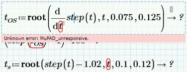

My MathCad document stopped working with this error message, and I cannot get it working again.
I have attached the document here, and a picture of the error message.
What can I do to make it work again?

The symbolic evaluation of the root function damaging the symbolic engine (muPad) sure is a bug.

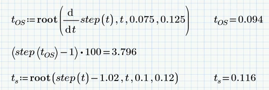

Solution is to delete the symbolic evaluations of the root functions, save the worksheet, close Prime and start it again.
I guess you won't need a symbolic evaluation, right?
