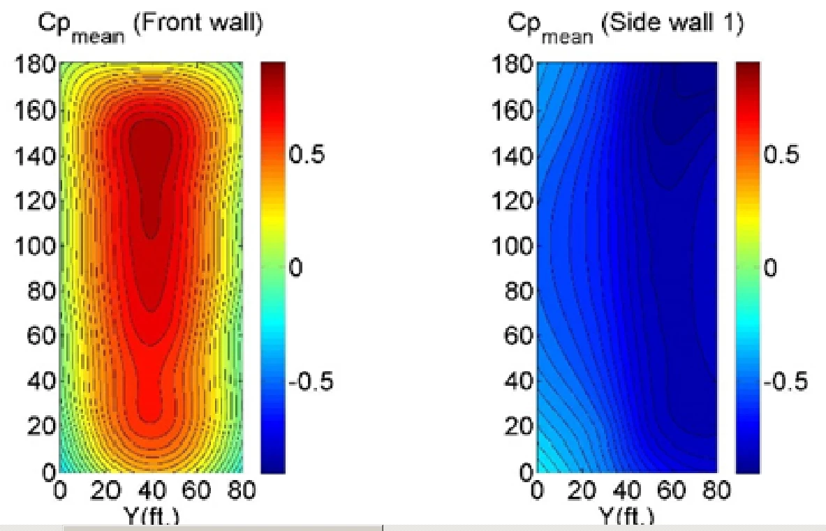

Can anyone recognize which software do these pressure diagram charts are made from? Can Mathcad do anything of this nature? Thanks
September 22, 2017
I don't know what made those exactly.  But GNU R can do them (or any other plot basically), and it's free.

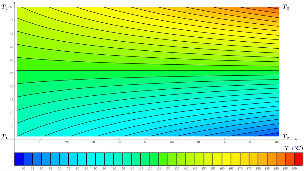

You can plot them also in Mathcad 14/15 but you have to construct the legend.
Sample enclosed.
September 23, 2017
See this on Mathcad 14 calculation server
http://twt.mpei.ac.ru/MCS/Worksheets/TMO/Pde-Temperature.xmcd
I have used two sepatate counter plots.
September 23, 2017
See please the temperature field created in Mathcad Prime
(one Fig. from the book http://www.springer.com/gp/book/9783319266732)
