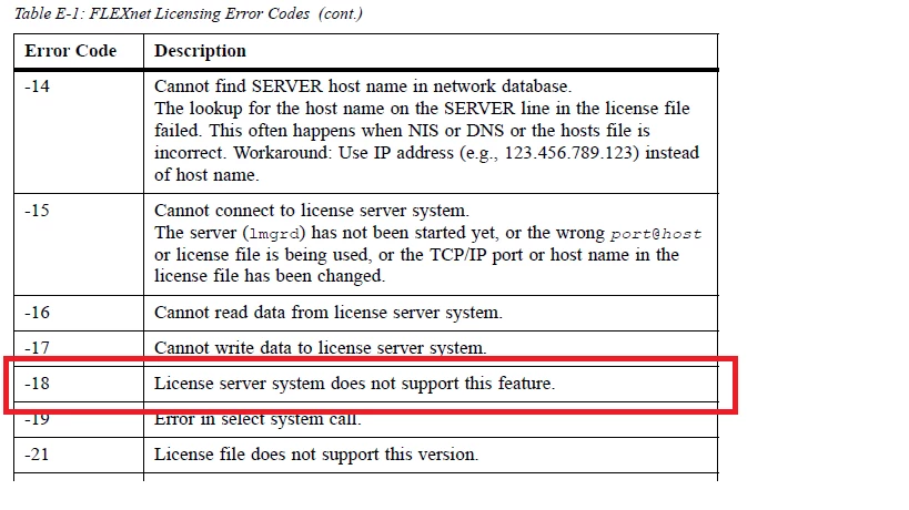

I am having trouble getting Mathcad to take a license from the license server. It comes back saying UNSUPPORTED: "mathcad" (PORT_AT_HOST_PLUS)(License server does not support this feature -18,327) when checking the logs in FlexLM. I have tried re-reading the licenses file, stopping and starting the server services
I'm hoping someone has run into this issue before.

Please run the file "ptcstatus.bat" from the folder "C:\Flexlm\bin" and show a printscreen of program window.
Error code "-18" means that "License server system does not support this feature" and this feature is "mathcad" (you can find FLEXnet licensing end user guide in attachment). But what kind of licensing options contained in your license file?
