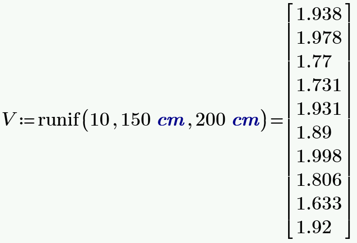

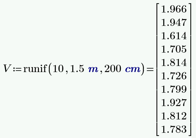

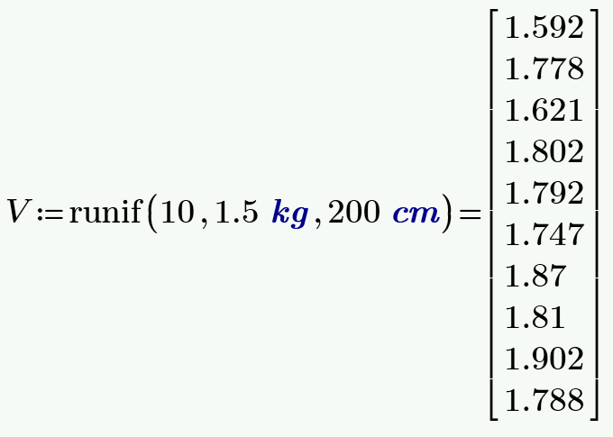

Unts in the runif-function
Is it a bug? The vector V must have an unit m!
LucMeekesAnswer
23-Emerald V
November 4, 2016
It's a bug. It should either:
- accept units in its argument but then also return units in the result
- Not accept units in its arguments, and return none (as Mathcad 11 does).

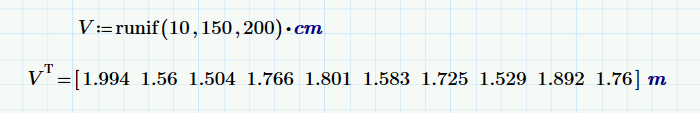

Default length is meters.  Numbers scale, but it seems to have stripped the units off.  A possible fix
