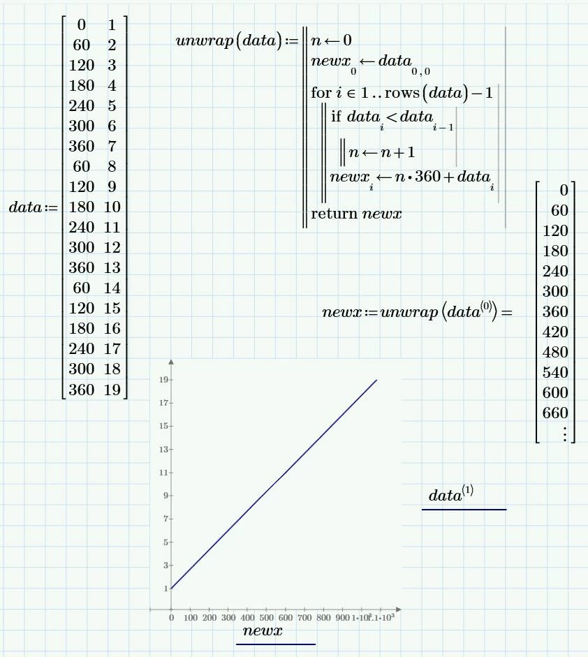

I have data where the first column is angle theta that makes ~5 revolutions (0 to 360 degrees) and a second column that corresponds to a 'y' value. I would like to graph the data from 0 to 5*360 degrees (0 to 1800 degrees on the 'x' axis). Is there a function that will allow the theta data to get adjusted? MATLAB has a function called "unwrap" that would be similar ("unwraps the radian phase angles in a vector"). Note: The angle theta is captured experimental data with some variation in the rate (i.e. there is a new data point ~every 2 to 3 degrees).
    January 30, 2022
    Have made up some sample data.  I think the unwrap program listed here is  what you are after?
    If in radians not degrees you will need to adjust.
    It is Prime 7 so someone may save it back for you.
    It does not take long to type in the unwrap function.
    Cheers
    Terry
    Cheers
    Terry

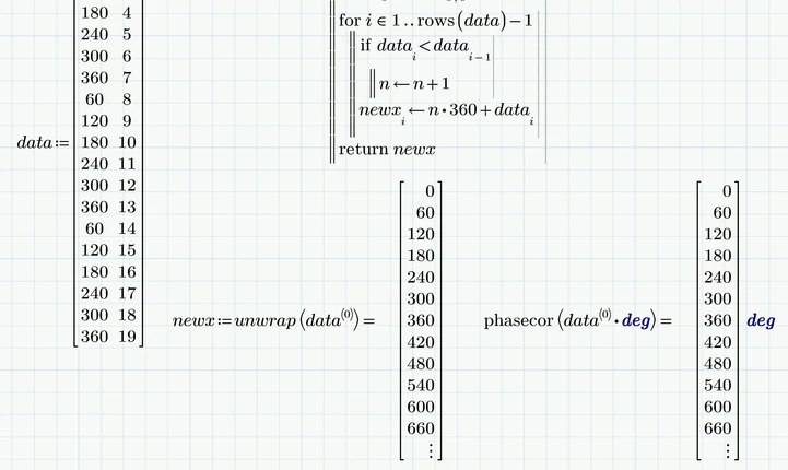

    I guess the easiest way would be to use the built-in function "phasecor".
    Of course the argument vector has to be a vector of angles. Here is Terry's example using phasecor
    January 31, 2022
    thanks!  That does work well.
