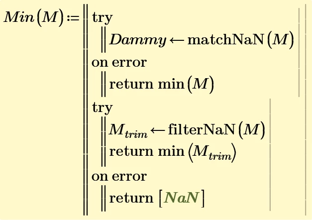

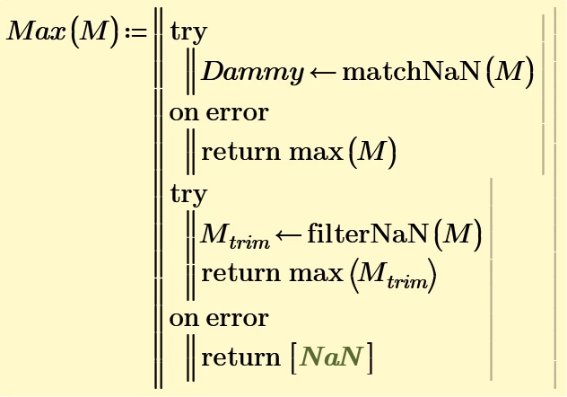

Using vector M, Edit: Without NaN fix.
t.t.
Aug 9, 2023 12:24 PM UTC
Which results do you get when you use a vector without any NaN's? 😉
EDIT: AH, I see that you have editted your post and fixed your functions to deal correctly with that case 😄

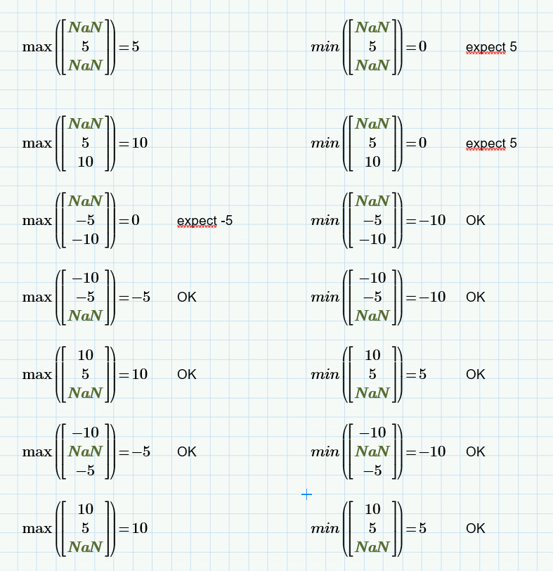

Manfred_F12-AmethystAuthor
Aug 9, 2023 12:42 PM UTC
I would expect that min() or max() filters out the NaN and calculates then min/max from the rest. If there is no value left (all values are NaN) then the result should be NaN. I tried several combinations and it seems to depend on the sign and position of NaNs:
