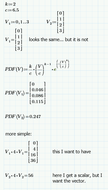

I have the problem that I would like to use a function with a set of values which are in an array. For example measured values.
My problem is that inside the function is a multiplication, so the vector is multiplicated with another vector. But I do not want this, I just want mathcad to take each value and to give out a vector with the results for each value in the input vector. This works if a range is defined but not with a vector. I understand that there is a matrix multiplication, but is there no way to tell mathcad what I want to do? Here is an example:
8 replies
Use the vectorize operator.

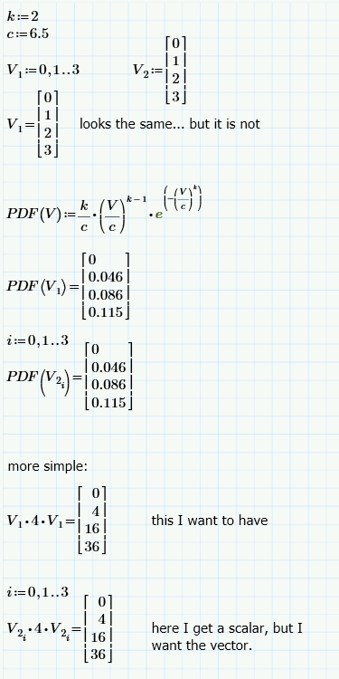

Thank you for the quick answer! I found another solution, but I like yours more. Anyway you could work with matrix indices.
There was an unanswered question where someone did it this way, just found it by accident.
Yes, you can use indices. That is a method that will always work, but if vectorizing works (which is usually the case, but not always) it is a lot faster. With very big vectors it can make a noticeable difference.
