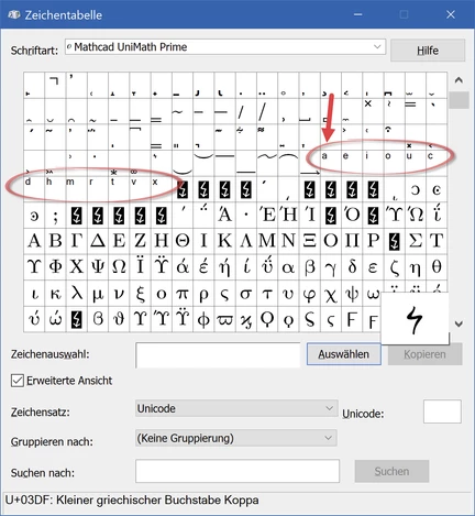

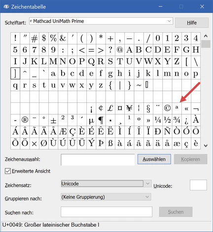

Mathcad dos not support variable names with superscripts.
What looks like superscript "a" is a "normal" sized character from the font used.
You can create that character either by inserting it from the Windows App "charmap"
or, as its the character with ASCII code 170 (unicode U+00AA) you can use the keyboard shortcut "ALT 0170" with numbers from the numeric keypad.
The fonts usually do only contain superscript number and a couple of letters (not all!) and some other symbols like an superscript  underline, degree symbol, apostrophe, etc.
A superscript "a" can also be found as Unicode letter U+0363 but the letters there look more like coming from a sansserif font.
So the fazit is that you can use some superscript letters but its a bit cumbersome and you can't edit such a variable name the 'usual' way by simply typing from the keyboard.
