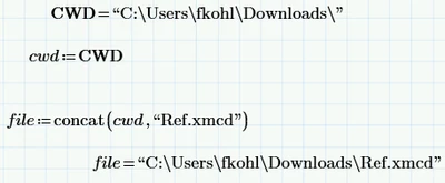

Use
concat(CWD,"Reference.mcdx")

Nice try. Unfortuantely it looks like the include reference function does not accept ascii string. Also I found this other thread, saying that there is no solution for this issue:
https://community.ptc.com/t5/PTC-Mathcad/Insert-gt-Reference-using-a-Variable/m-p/353759
