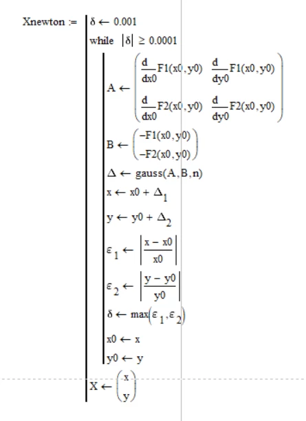

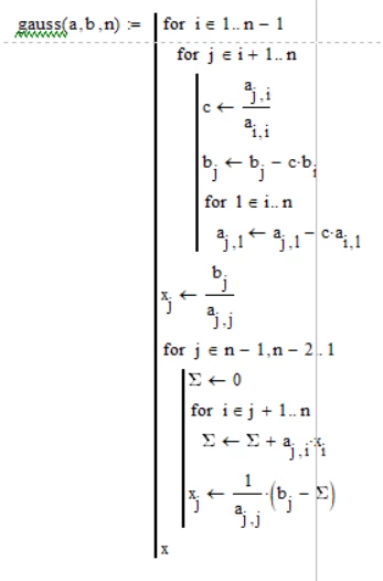

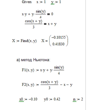

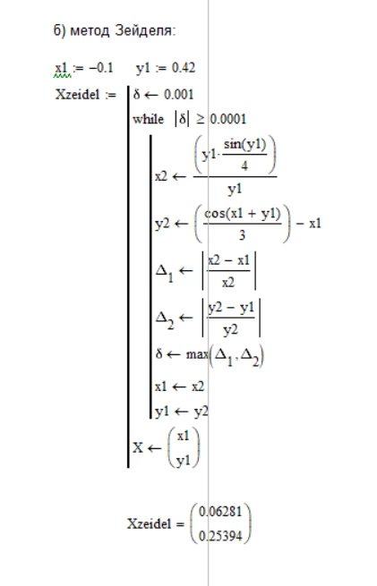

Hello there,
This program I rewrite it by changing my own numbers only. Sadly I don't understand how this program works. Do you mind how to explain how this program works?  Appreciate for the help.

Thanks for the reply. The  exercise is name under Zadanie 12 (задание 12)
