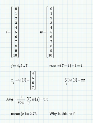

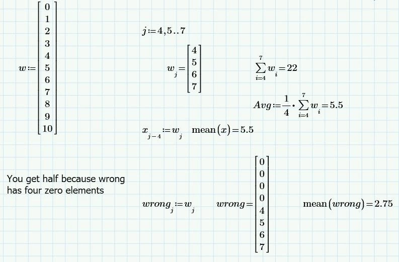

You get half because x has four zero elements that lower the mean
