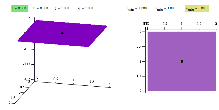

August 7, 2018
Here is a small animation - simply used linear interpolation of your vectors of forces.
I attach the avi-file, too, as its usually more convenient and embedded videos often fail here.
EDIT: As the embedded video still does not work, I replaced it by an animated GIF.

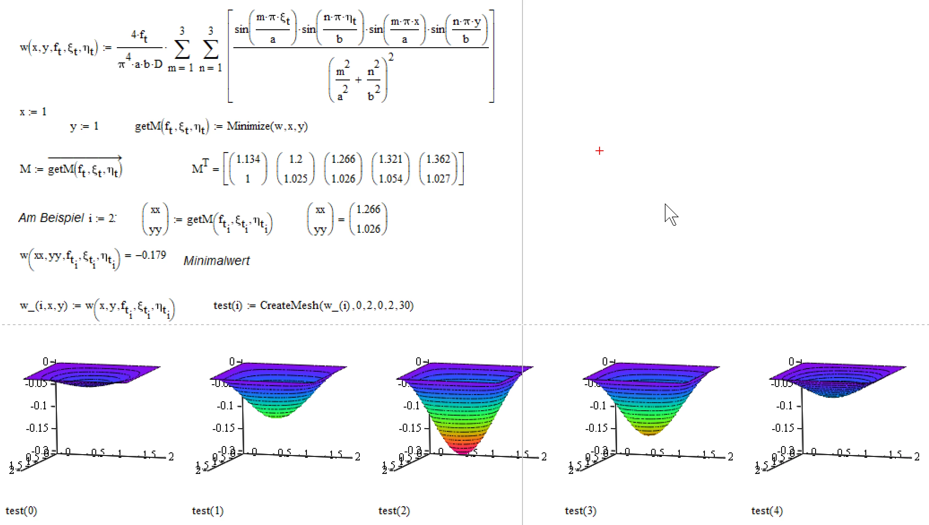

August 7, 2018
So you can test your answers here is another approach for a simply supported plate.
Cheers
