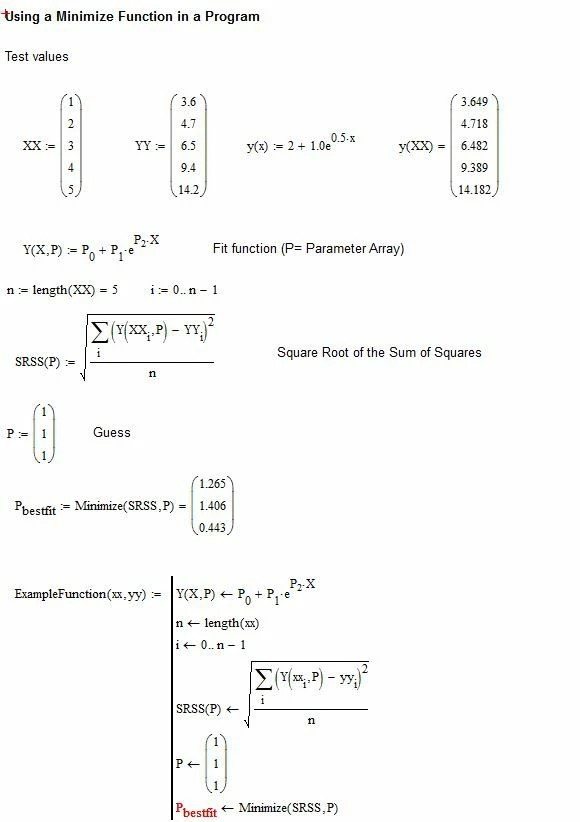

I would like to be able to use the Minimize built-in function in a program.
I am obviously making something wrong (see attached example).
I understand that (even if one does not need to write it explicitly) there is a "solve block" involved.
Is it possible to use a solve block in a program?
thanks a lot for any hints.
Best regards
Claudio
PS: I do not succeed to attach the file, it says "the content of the attachment doesn't match its file type"

You cannot use a solve-block inside a program, but you can assign the result of a solve block to a function.
See here for some examples:https://community.ptc.com/t5/PTC-Mathcad-Questions/Successive-solve-blocks/m-p/477785

You can create a function that calls Minimize, then use that function in a program.
See attached.
Yes... I was just testing that after the first answer, and of course it works ... thanks a lot Fred!
