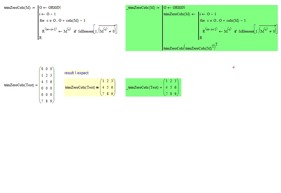

Dear forum,
Does anyone know what the error is and why it doesn't give the result I expect?

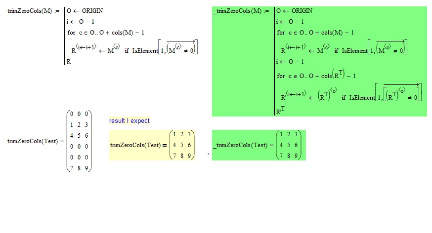

I don't understand why you expected a different result than the one you got!
The function does exactly what its name suggests - it deletes all COLUMNS in a matrix which consist of all zeros.
The function does not claim to deal with the rows, so rows with all-zero values remain intact.
To remove the all-zero rows as well you need a function trimZeroRows( ). But you don't have to write that function, simply use trimZeroCols on the transposed matrix and then transpose the result.
So you can also easily create a trimZeroRowsandCols( ) function in one line:
BTW, here is an alternative trimZeroCols( ) function which does not make use of my Is Element( ) function

  Hello, CarlosRomero
  It seems to be :
   Best Regards.
       Loi.

Thanks Loi and Werner.
A good solution Loi.
Werner, thanks for pointing out that to delete the rows it was only necessary to use the transposed trimZeroCols.
I attach your alternative function that does not use IsElement but returns an error?
CarlosRomero
Feb 23, 2024 3:41 AM UTC
Uhh, that one was a bit tricky 😉
Right click at the bar after the sum symbol. The menu which pops up gives you (amongst others) the choice between "Absolute Value" and "Square Matrix Determinant". Check "Absolute Value" and the function works OK.

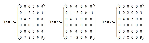

   Hi, again, CarlosRomero.
   So far, I guess your this question has NOT been solved with both of ORIGIN := 1 and ORIGIN := 0 !!! 🤔
   With :
      Regards.
         Loi.
