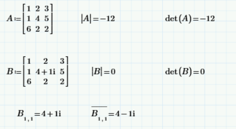

Using Prime 3.0, the determinant function does not handle a matrix with complex numbers. Don't how to fix it.
When I load a matrix up with al reals the |A| or det(A) works fine and returns the value.  If I add a +1i or any imaginary number to an element, the |A| or det(A) returnb 0.  This frustrating since I have programs that use this alot for filling arrays in a linear systems problem.

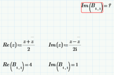

It understands that the middle element of B is a complex number. It can produce it's complex conjugate, but the Re() and Im() functions are considered 'Premium' function, although you can easily circumvent that by defining them using the complex conjugate.

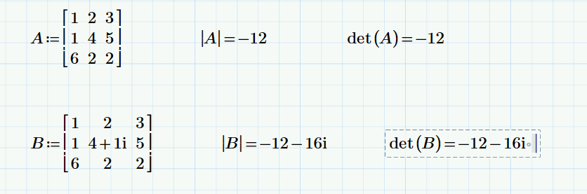

Anyway, this is what Express Prime 3.1 produces (typed everything in myself):

From my 3.0:
February 16, 2017
I typed Fred's example into Prime 3.1: No Good
I typed Fred's example into MC15: Good
I converted MC15 to Prime 3.1: Good
I did copy/paste of converted elements into new Prime 3.1 worksheet: No Good!

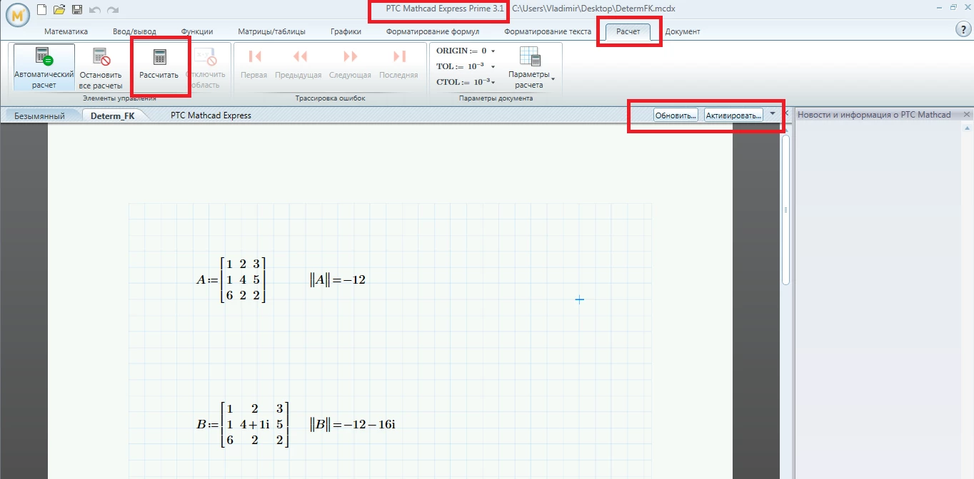

After opening the document "Determ_FK.mcdx" in Mathcad Prime 3.1 Express and recalculation (button "Calculate") there are no errors:

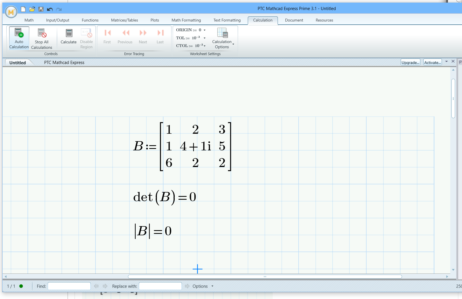

We do not know which version of Prime Foster has. Maybe he uses Express Prime and there may exist the difference between full Prime and Express Prime. If I tried to calculate the determinant of Fred's matrix B in Express Prime the result was 0.

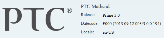

I do not have Express, full up Prime 3.0:
March 1, 2017
I use Prime 3.1 32-bit (F000 (2015.02.25.001/3.0.0.266)) with .NET Framework 4.6.1.
February 17, 2017
Fresh install. downloaded from PTC website

Windows 10 64-bit (1607, 14393.693)
PTC Mathcad Express Prime 3.1 64-bit, F000 (2015.02.25.001/3.0.0.266)
.net 4.6.2 (DWORD version 394802)
