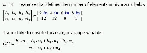

I'm trying to define a variable (shown as 'n' below) that will create a matrix of 'n' columns and subsequently use the values in the matrix to perform arithmetic operations:

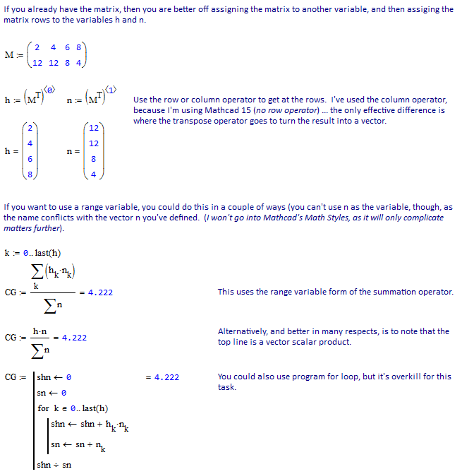

I don't think it's possible to do exactly what you want in Prime.  There is a solution in Mathcad 15 (& prior) using scripted components.

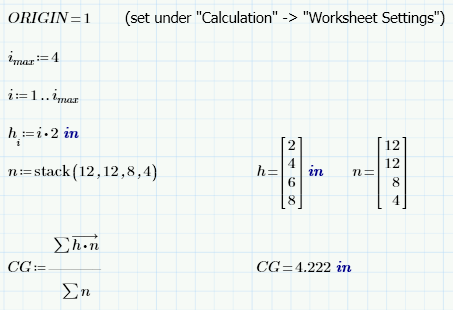

Here's my stab at a best solution for you in Prime:
This sure should be no problem
You will have to tell us, how those values depend on n
It looks like h_i=i*2 in, right? But what about the values of n_i ?
Again - should be no problem.
So all what remains is that you specify the values of your matrix.

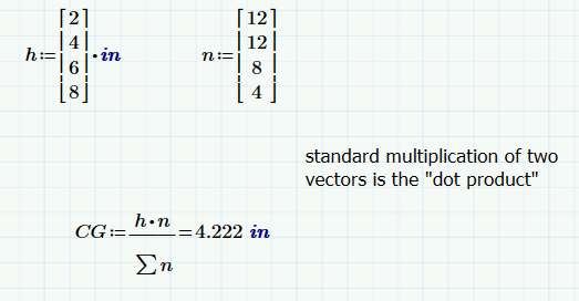

It's not clear to me why you're working so hard!  define a vector of lengths and a correlating vector of numbers.  (You had to type those in, right?)  Then vector math is simple:

Just a variant on the already proferred suggestions ...

Looks like I need to give a little background:
I am trying to create a BLANK matrix of elements based on the number of rows of items I have, but the number of rows is not a constant from one design to the next.  To clarify, the values of 'n' & 'h' are totally independent and do NOT depend on the number of rows, i.e., my range variable.
where      n = number of items/row (or total area if each has an area of 1)
                h = height of row from a horizontal reference
So, my worksheet is calculating the center of gravity of my items which all have the same area.
