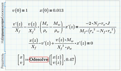

I want to solve this problem using rkfixed function in mathcad prime 2.0. Help would be highly appreciated!
I am having trouble understanding the derivative matrix of this function

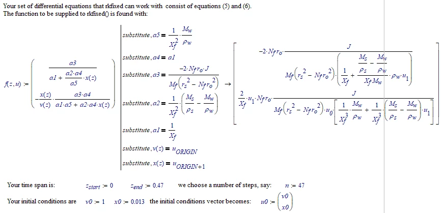

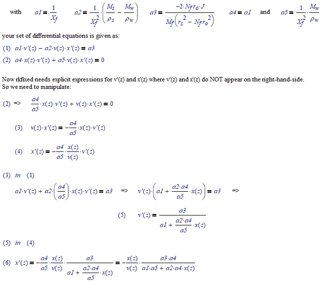

OK I found them (they are there today, they weren't yesterday. I wonder where you grabbed the second from...because both equations define v(z)*x'(z). And I wonder why you use d v(z)/dz on one occasion, and all other derivatives use prime notation:  v'(z) and x'(z)...?
Anyway, here goes:

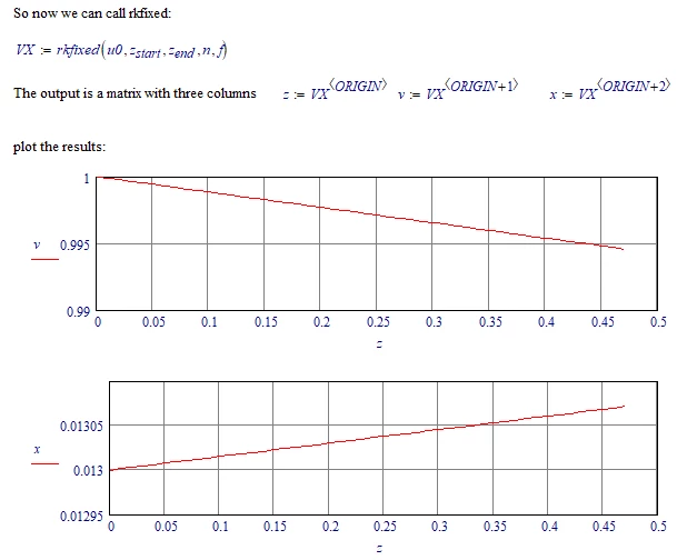

With such results choosing 47, 470 or 4700 steps makes no difference in the graphs.
Possibly not the solution you expected.  I suggest you check your differential equations once more.

I think first you have to clear up what the function x'(z) is. It is not defined. Do you need to solve two functions ( v and x) simultaneously (which isn't impossible, but requires a set of functions to rkfixed.)?
I suggest you look up the example  for "Solving a First-Order ODE Initial Value Problem" in the help. That should explain the usage of rkfixed.

Right! I have two equations which contain v(z), v'(z), x(z) and x'(z)

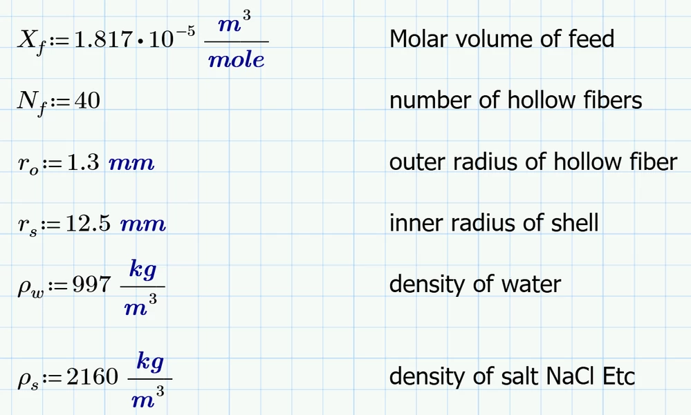

the rest constants are known
initial conditions are known: v(0)=1; and x(0)=0.013
I need to solve it from ini=0 to end=0.47
I need assistance in forming the derivative matrix. It would be highly appreciated!
Further in the first equation we can assume the value for variable x'(z) as a constant as 0.5 and put the values of v(z) and v'(z) in the second equation to obtain x(z) and x'(z) then iterate the procedure.
I need to use rkfixed to do this.
Thanks!

Why do you not use units?
Asad1-VisitorAuthor
because most of the times they cause a hindrance

I tried to solve the first equation but it gives an error saying about derivative function D that this function cannot be used here.
File is attached.
One more try - with Odesolve - why not!
