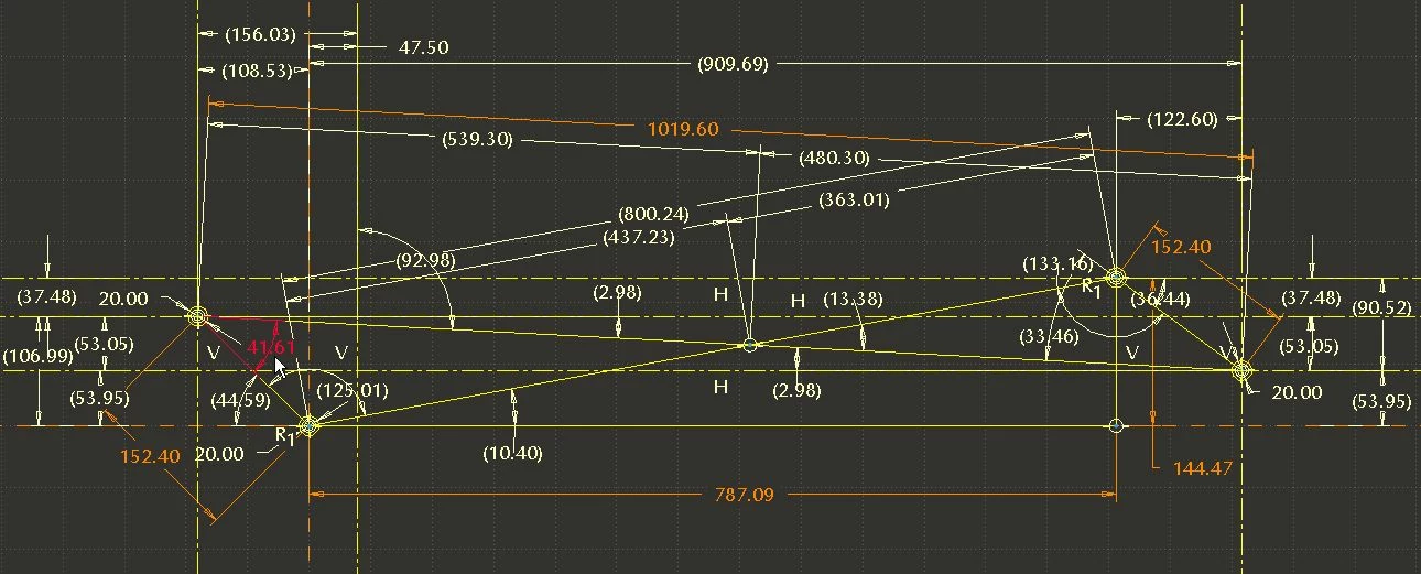

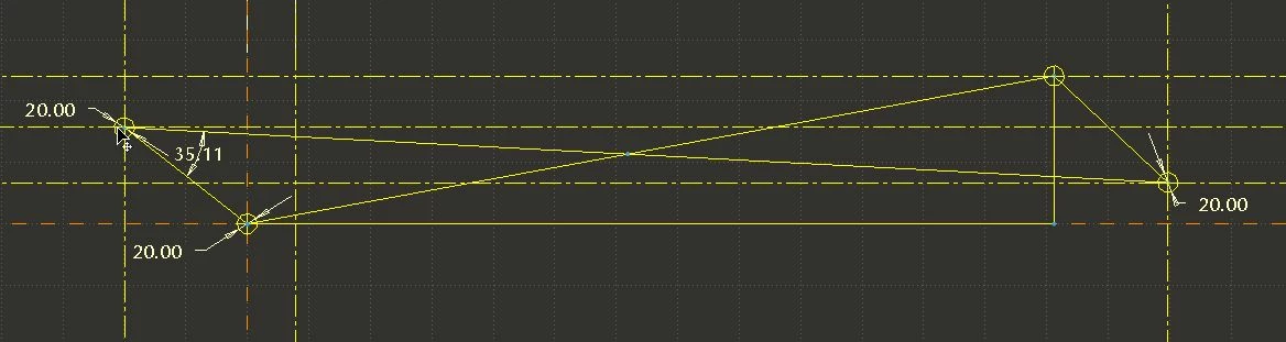

I'm trying to solve a system of equations for a 4 bar linkage for all the geometry and the forces. For some reason the comparitor functions are not actually constraining the system as they should. For example all angles inside a triangle should add to 180deg (pi). ProE does this. MathCad solve block allows this is float slightly off (therefore giving incorrect geometry).
I modeled it in ProE and locked down the geometry I wanted fixed. The main input is 1 of the angles and everything else should be solveable from that.
I've attached 2 MathCad files. 1 for the geometry (using law of cosines and basic trig). Another for the FBD using primarily law of cosines. And a 3rd trying to solve the geometry using only angles and basic trig.
I also attached the FBD sketched out...
Anyone have any advice (specifically on how to "lock down" constraints, if possible)?

I decided to put in the entire FBD and see if it could solve it (20 unknowns).
It worked and gives result similar to what we've measured in an actual machine.
Very good, but note that you have used 24 equations to solve for 20 unknowns. You can safely remove, say, the last two equations for theta12 and theta14, and the last two with theta 23 on the LHS (all in the 4 bar linkage section) and still get the same result.
Pete
Assign the angles to the solution vector! See attached.
Alan
