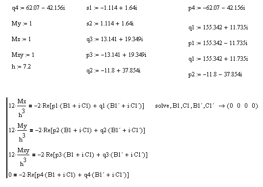

I would like to determine 4 variables with equations but it's returning (0, 0, 0, 0) which is not correct.
I think the way I placed the equations is not right.
Can anyone help me with this?
Thanks!!

Attaching...
March 24, 2014
For the symbolic "solve", the equations must be put in a vector, not a program structure.
As it seems you are just searching for a numeric answer, you may also consider using a Given-Find() solve block instead.
