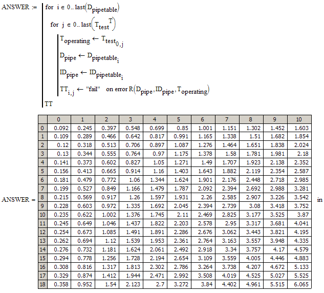

I guess here is what you were trying to do.
Using the guess value TH.i=4,59 in, the solve block fails for the first five diameters at 200 °F.
Fortunately changing the guess to 2 in makes the whole table work OK:
If we weren't able to find a guess which satisfies all combination of input values, we could have made the guess an additional argument of the function R and would have to find a way to precalculate a suitable guess depending on the three input values.
