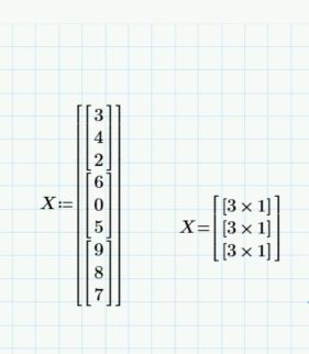

If a have a nested matrix like this one below
and I want to exclude the first row  of each small matrix in the original one
How can I do that , when I try (submatrix function) it excludes the first matrix , but I want to exclude the first row of each matrix
by the way my ORIGIN =1

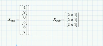

I'm expecting the answer to be like (X sub ) in the second picture
Yusra

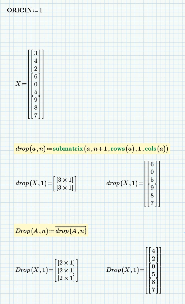

Hi Yusra,
Do you mean something like the following?
Stuart
23-Emerald V
Jan 30, 2026 1:07 PM UTC
Hi Yusra,
Stuart
Jan 30, 2026 1:09 PM UTC
exactly thank you Stuart
