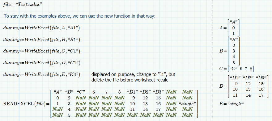

Here is a hopefully handy routine in Prime which constructs the matrix from different variables. Similar to augment() but dimensions do not matter and empty cells are filled with whatever you want.

Here is a way to do it using the Excel comopnent. I'm anit happy with it but you have to decide yourself what fits better your needs.
August 11, 2013
For completeness sake I added is a self written routine WriteExcel() for Prime which can write to any position in the sheet, not just beginning at A1. Similar to WRITEEXCEL in Mathcad 15 and below. Don't understand why they removed and changed that feature in Prime.
Limitation of my routine is that it will only write to the first sheet of the Excel file - you cannot specify the full range including sheet name but only the starting cell in the first sheet.
I guess the routine will be rather slow on big Excel tables, as it would read the whole Excel sheet in a MC matrix, adds the data there and then write back that matrix.
As the task was done in Mathcad alone its a bit lengthy routine and still may contain errors - feel free to report them here.
