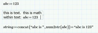

You can include a math region within a text region.  Or, you can convert a number to a string and concatenate it with other strings.
If you want the actual contents of a text region to change, it might be possible with scripted components in Mathcad 15 (or prior).
