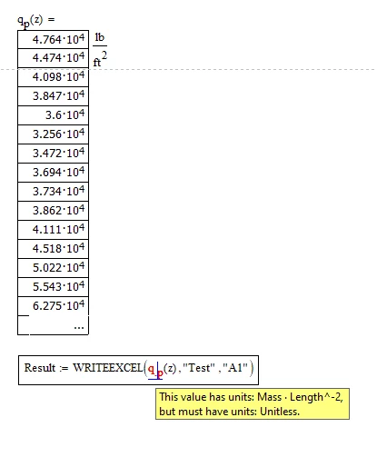

I'm new to Mathcad and have just taken over a file from someone at work. It runs fine but I am stuck manually copy pasting the results into an excel sheet. I want to automate the process and have tried using the WRITEEXCEL function but I can't seem to get it to work. See attached photo.
I believe it has something to do with the function qp(z) not being a matrix or array but I'm not sure. I've also tried defining M:=qp(z) and using M in the WRITEEXCEL function but that gave me a "variable is not defined error".

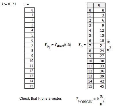

Create a range variable i, and use that to (iteratively) create a vector result of your function:
Note that I (deliberately) created the vector as a literally subscripted variable Fp (I typed
F.p
to get that), then added an index to it by appending:
[ORIGIN
This to show you once more the difference between a literal subscript and an index...
Anyway, now you have a vector result, but it still has a unit, and you cannot export units to Excel, so you'll have to divide that out. With an array that is possible, and it can be done as:
6 replies
As Excel does not understand units, you can only write dimensionsless data to an Excel file (the error message also tells you, that the data must be unitless). So use q.p(z)*ft^2/lb  (instead of just q.p(z) ) as argument in the WRITEEXCEL function to get rid of the units. Furthermore I think that the filename must include the extension ".xlsx". Specifying "A1" as starting cell should not be necessary, you can do without.
BTW, its always better to include the worksheet rather than just a picture. I can only guess that z is a range variable!? If thats the case, the export will not work even when using the correct syntax and unitless data. This is because q.p(z) is NOT a vector if z is a range. That may also be the reason why M:=q.p(z) does not work OK. The argument of WRITEEXCEL must be a vector!
It would be necessary to see the sheet for further help, though.

I've attached the Mathcad file and the excel sheets it reads from. As you said, I think the issue is that q.p(z) is a range variable, not a vector.
 Is there any way to convert a range variable to a vector? I've tried defining a matrix: Q.z=(q.p(z)*ft^2/lb) but that doesn't seem to work. I tried to follow this:

There's a VERY simple test to see if a certain variable is a vector. Consider the variable F, and type:
F[ORIGIN=
If that results in an value, then F is a vector. In another case F may be a matrix, in which case
F[ORIGIN,ORIGIN=
results in a value. Otherwise you will have received an error message that F is not a vector.
Apart from that, it seems that in your sheet z has a unit (ft). That is not allowed for an index. The index (the pointer to an element of a vector or a matrix) must be integer (a whole number) AND unitless.
Try to see if using i as an index works.
Finally you should know that there is a huge difference between an indexed variable and a literal subscript.
You get the variable F indexed by typing [ and then the index (a number or a range variable) after it. E.g. F[1 for the element with index 1.
You get a literal subscript by typing F.1, that gives just a variable F1. (where the 1 is in the subscript position)
