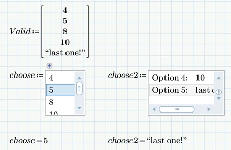

Werner_EAnswer
It doesn't look very nice but you could use a scripted list box with your data vector as its input.
Prime 10 file attached

DJNewman
Yeah, you can copy paste your array into a combo box (right side; you don't even need to fill in the left side) and set the definition variable of that to Valid: if you want.

In the actual sheet  data is not fixed . It will be calculated  and will then have  to make its way into the section box.
Werner_E25-Diamond IAnswer
I have been trying to do this since 10 was released. Thank you. Works great.
