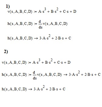

I recently downloaded the trial version Mathcad 15 M045. This is the problem:
when it evaluates a symbolically expression i have to insert "->->". Why ? Thanks a lot

-> is one operator fpr symbolical evaluation.
You have dot a derivative!

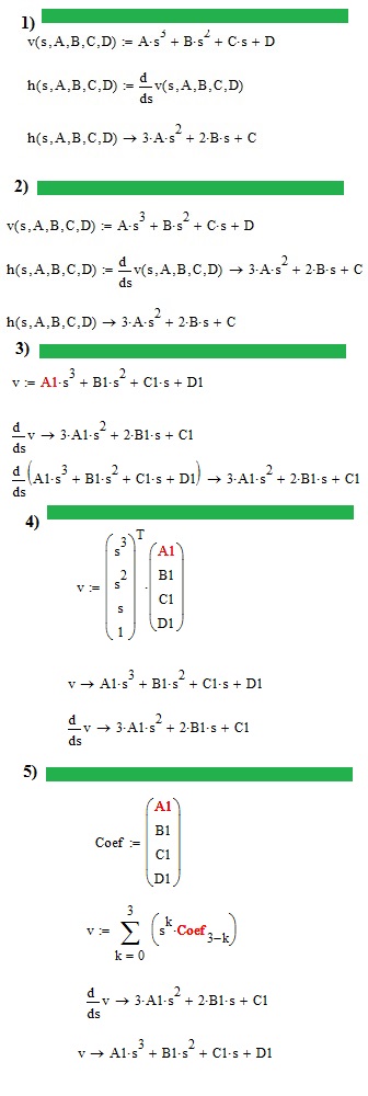

Hello! you   could do with undefined coefficients so as well :
June 20, 2016
The problem is the combination of assigning the result to a variable/function and the constants A,B,C, D not defined which makes the numerics cry.
If you don't assign  it works
If you assign and provide the constants as function arguments to make the numerics happy it works, too
Its an annoying behavior and I was not aware of your workaround using 2 symbolic evaluations in a row
Another way to cope with it is to evaluate additionally in an extra region
and you may even omit the first symbolic evaluation
WE

After the symbolic calculation you can replace the arrow sign on a equal sign (right-click on the solution and then select "View Evaluation As" --> "Equal sign"):

Thanks for your answers.
In the old versions of Mathcad I just had to write "v(s)" instead "v(s,A,B,C,D)".
I don't get why that's changed.
I add a screenshot of the old version.
June 20, 2016
The same applies to newer Mathcad versions - your expressions works the very same. Only difference is that you don't see the derivative (sometimes, when you move the regions around, you can even manage to make it visible - strange effect).
I don''t know when and how this behavior was changed - maybe when Maple was replaced by muPad in version 14, maybe earlier when the catastrophic version 12 saw light.
You have a couple of easy workarounds at hand if you insist on seeing the derivative and so I would call it a minor annoyance.
