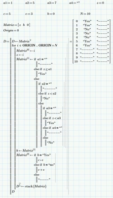

I'm using MathCAD Prime 10.0.1.0 and having difficulty having a function complete a different formula depending on if a previous variable is either "Yes", "No" or "Blank".
The loop is meant to repeatedly calculate "b" and then determine if "b" is either a "yes" or "no", I added a blank option to allow the calculation to be skipped in a larger document if that section is left blank. However, it is just always registering the "b" variable as "blank".
The answers need to be provided in a matrices format.

Are you looking for something like the attached?
Some notes:
When you choose Matrix^<1> using the column selector, you get the column, not the element. In your case you would get a 1x1 matrix containing the string "Yes" or "No" and NOT the string itself.
You had a typo, as Prime would consider "no" and " No" as different strings.
