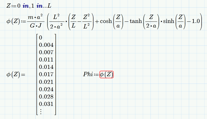

I don't understand why I can't evaluate the equation in attached spreadsheet  -- bottom of the page.  It keeps telling me the independent variable is undefined?  Can someone explain what I'm doing wrong?  I would like to also take the first, second, and third derivatives of this equation, but can't do that without being able to evaluate the equation.

Two problems:
1) first you are trying to evaluate a function definition which has to fail. You would rather define the function and then evaluate in a separate region.
While it looks like you get what you expect, you won't have much fun with the result as you can't save it to a variable or use it other than just looking at:
The result you get is NOT a true vector (unfortunately it looks that way but its just some sort of list/sequence which is og no use for further calculations. Thats because

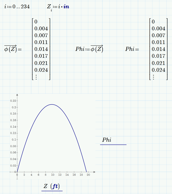

2) you use a range variable as Z and not (as you should) a vector. Define Z as vector and call Phi with Z as argument to get a true vector which can be assigned a variable and you can grab single values from or plot. Don't forget to vectorize the function call when you use a vector as function argument!
OK, I am not sure if I had scrolled down far enough in your sheet. I stopped at the first error which was not because of the missing data file.
Concerning the last error in your sheet it really looks like you forgot to define t.fl and b.fl.
Not sure which "equation" you were talking of in your initial question, but keep in mind, that you can only take derivatives of functions, not of equations!
