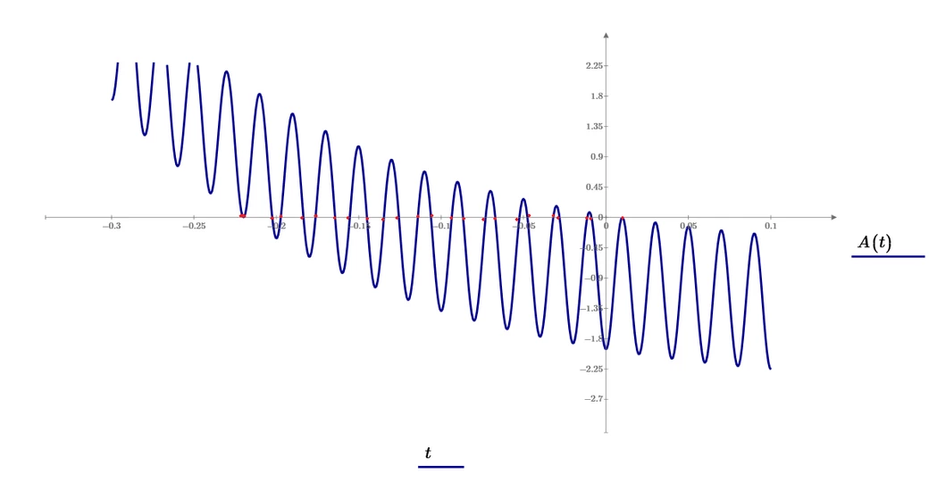

I want to see a variable from an equation. But I did some practice, and I couldn't get any solution. Can you help me I attached the file. 🙂
Werner_EAnswer
Sep 22, 2023 1:03 PM UTC
You should define A(t) as a function like this
The way you defined it the function would only return 0 or 1 (false or true) because it was a boolean expression.
Now you can evaluate it at any position t
Unfortunately the symbolic solver is simply not capable enough to solve your equation

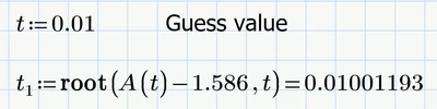

So you should use the numeric methods of Prime, either a solve block with "find" or the "root" function.

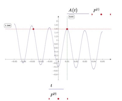

As your equation has multiple solutions as Cornel already stated, you get different solutions for different guess values
You may also use the root function without a guess value if you provide a range for the t-values
Here you see these three solution in the plots

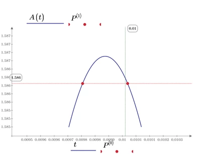

We cannot distinguish the first two so we zoom in

or at a different position and this time using the root function with a guess
