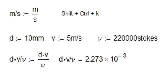

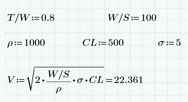

Hi all,
I want to have variables as follows: T/W=0.8 or W/S=100 etc. However Mathcad  won't let me define a variable like that, because I think it actually divide or sth. Is there a way around this?
I don't need to know the W or T, I just want to use T/W or W/S ratio in subsequent calculations.
As an example if I want to solve for V=sqrt(2(W/S)/rho*sigma*CL), I would just use the W/S ratio that I would have already defined.

Only in Mathcad 15
And there is one way to do it in Prime 2 and 3

I know one hydrodynamics-man who believes that Reynolds did not come up with this criterion and makes calculations as follows:

Prime?
If you need colored operator - use pls the template in attach
November 26, 2015
See please one more sheet with var1/var2 ratio graph
And sorry, Christopher, is my answer correct?

November 27, 2015
Yes. I marked one of your answers as correct. Thanks!
