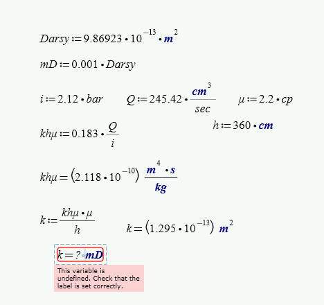

my problem with PTC MathCad 3.0 is illustrated in attached picture.
While I get correct answer and units of k (permeability) in square meters, but I can't convert answer into Darsy (Darcy). Where can be problem and what is the solution? Thanks a lot.

I believe the problem is that "mD" is not a standard unit. Did you define it as a unit elsewhere in your sheet? If not, select the mD definition as you show and under Labels, select Unit.
I hope this helps.

To define a new unit, select the name of the unit where you define it (select "Darsy" in the first line of your screenshot), and then select "label", then "unit". Do the same with the second line and "mD", and your problem will be solved.

Thanks, pals. I Marked as correct answer the first one, but actually both of them helps.
