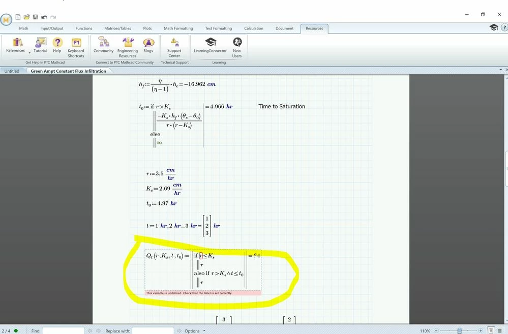

I'm getting the variable undefined error for variable "r".  Any suggestion?Variable UndefinedVariable Undefined

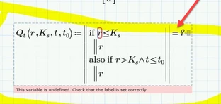

Delete the equal sign (evaluation) after the function definition!

Three suggestions:
1. Attach your worksheet. It is very hard, to sometimes impossible, to debug pictures. State which version of Prime you are using.
2. Check the labels of the various variables named 'r', to see if they match (= they're actually the same variable)..
3. What is the function supposed to result in when r > Ks and t >to? You need to account for ALL possible outcomes.

Hi Sapphire I, Attached is the worksheet. It is in Prime 5.0. I could not find how to upload the file in the Community web site. Hope this work.

No worksheet attached.
To attach a worksheet, use the 'Browse...' button below and to the left of the message edit window.
vip1-VisitorAuthor
July 23, 2019
It works.
