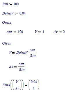

I have no idea what im doing wrong as usual with Mathcad. I have been forced to go back to Mathcad 15 because i no longer have prime.
Why am I getting an error that says undefined variable.
I am defining a few variables above that are hard set
Defined above
Rin:= 100
DeltaV := .04
Intial Guess
out:=100
given
V = DeltaV * (out/Rin)
Av = out / Rin
find (V,Av) =
And all i get is variable undefined

If you want to solve V and Av, you HAVE to provide initial guesses for V and Av...
December 15, 2019
Obviously you are missing the guess values for the variables you are looking for.
I wonder why you are using a solve block for this, as you could calculate Av and V also directly using the values you defined earlier.
out is NOT a guess value, as you write, because out is not a searched for variable. So out will hold its initial value 100 throughout.
Looks like you had something different in mind.
You sure should be able to attach your Mathcad worksheet. What problem do you experience when you try to attach it here (you sure can't embed it, of course) ?
